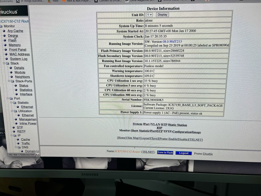

After reading many forums, I the routing preference on my Switch (ICX 7150) is messed up.
The running Image version is Complied on Sep 23 2019 at 00:00:25 labeled as SPR08090d.  I think this is why when I am using the Extender, my internet lags and sometimes do not work.

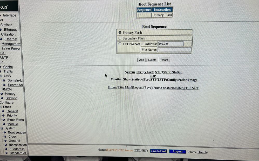

I followed something else I saw on these forums where it instructed me to go to the Boot Sequence (using the GUI)..
Let's fix the issue, please follow the following steps to fix the issue, forcing the Switch to boot from the primary partition containing the SPS (switching code).
Configure left>System>Boot sequence>Select primary flash >ADD>Save>yes
When it comes back this time, the Switch should boot from its primary partitions.

Mine looks just like his.
i followed those instructions and it did not work.

Since the issue relates to the Secondary Flash being booted up first, is there a way to delete/remove the secondary (SPR) so that it no longer shows up (from the GUI that is).  I don't think I will be using the switch as a router
Nothing has changed.  Issue stays the same.
