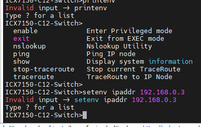

I logged in with the password.   Then, when I tried to setup ip address, the commands are no longer available.

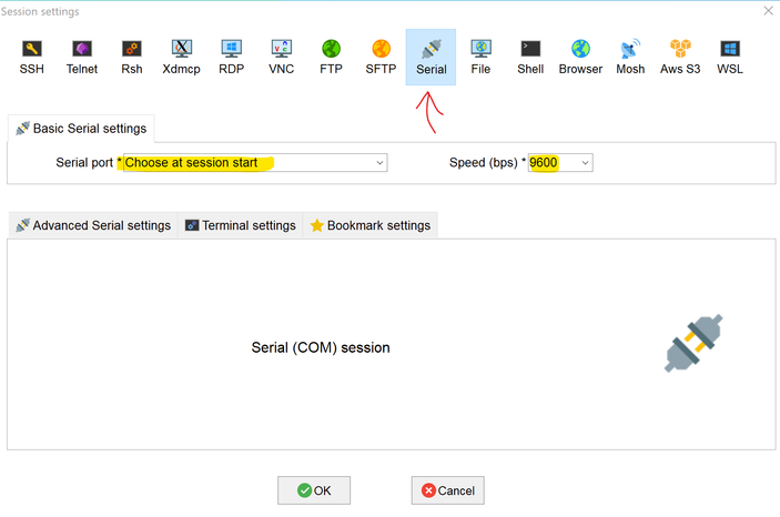

Hi robinparky
We have to enter those commands in boot> mode
Please start a Serial connection as shown in below Screenshot and perform the commands:
Imran_ruckus_0-1677542899899.pngPlease refer to the below guide link as a reference:
