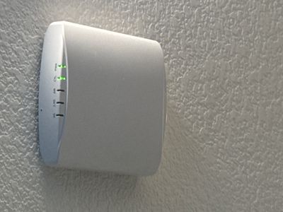

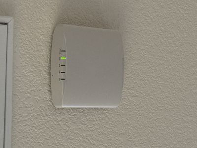

There was an outage but it took a while for us to fix the ICP 7150. Now the boxes are the ones not working since there areas in our home that have no or weak internet. One box has blinking ctl and pwr. The other has a steady ctl light but blinking pwr.
