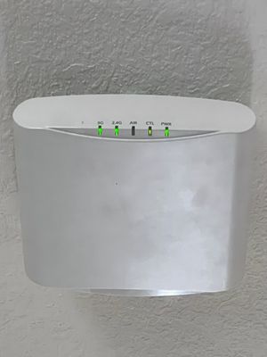

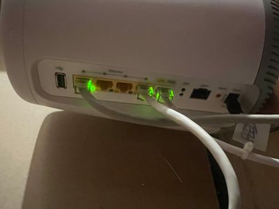

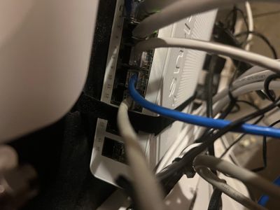

Rockus not working
Ashrafmehdi004
17 REPLIES 17
Brother
If you have a call 📞 with me it will be resolved faster, I am stuck on it from last 5 days and still no results
