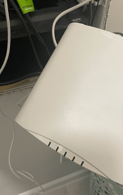

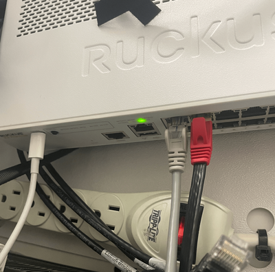

RUCKUS ICX 7150-C12P stopped working and no status LEDs are on and PoE is off.
After the factory reset LEDs kept blinking forever
This unit is from a 2018, Lennar home, with SN FEK3822Q541

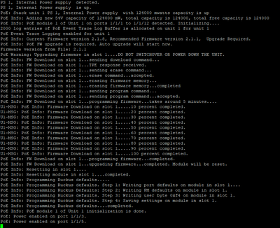

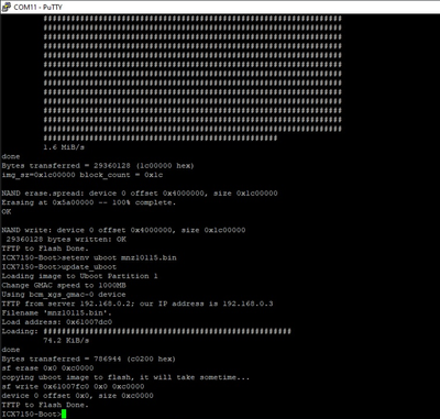

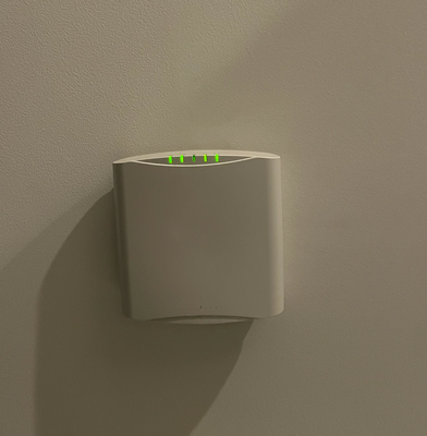

It worked with the firmware restore option. The following needs to be improved with better presentation. It would be helpful if you have to restore documentation for Macbook Pro(2015 and M1 Pro)
