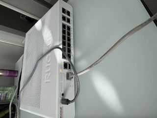

Based on the picture you shared, I can see that the RUCKUS Switch now has a green LED for both the PWR and SYST indicators, which confirms that the Switch has returned to its normal state.
At this point, you can reconnect all the cables as they were previously configured to restore full functionality.

Could you please let me know at what step during the Software Recovery process you are stuck on? and share a screenshot of the error (if any). Additionally please share a picture showing the Software Recovery cable connection between the Switch and the laptop.

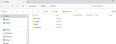

11-11-2024 02:14 PM
Trying it again on a borrowed pc. I got as far as unzipping the ICX7150 file folder. But there is no "Boot" folder. Only Firmware, Images, MIBs and Signatures.
