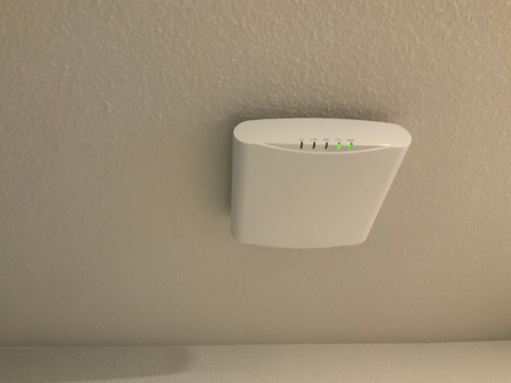

Here are pics of the lights. The power flashes green every second or so. The 3 g and 5 g lights are not on or no green.

Did as instructed and the power is now solid green, but the 3 g and 5 g are solid orange. Waited 10 min and no change.
09-21-2023 01:41 PM
Hi @busch007
From the pictures you shared, as per the light status and the cable connections, they seem to be normal. Are you able to see a Wi-Fi SSID broadcasted from your RUCKUS R510 Access Points and connect to the Internet with the same with your wireless device?
Please note, that Amber lights on 2.4G and 5G is a normal behavior.
If 2.4G and 5G lights are amber, it states that the connectivity is up and there are no devices/clients connected. When any device/client connects to the 2.4 or 5G radio the lights turn green. Please refer to the below link for more information about the light status of the RUCKUS R510 Access Point.
