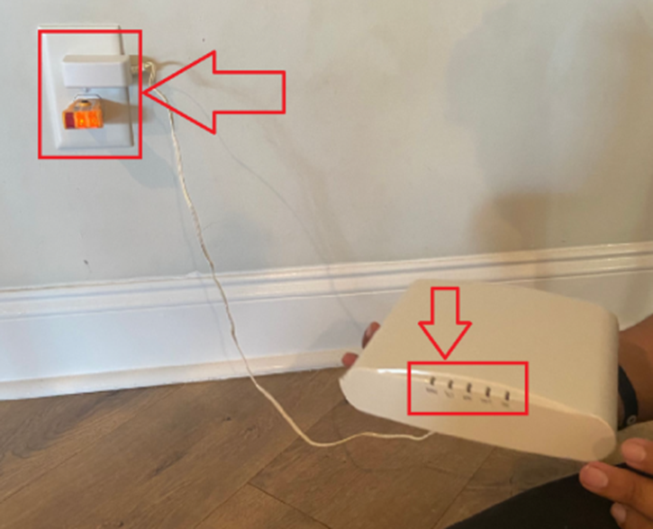

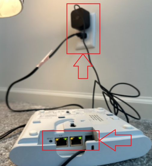

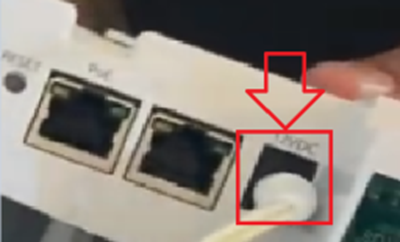

We kindly request that you connect your RUCKUS R510 Access Point (AP) one by one to a functional power outlet and share both pictures and a single video showcasing the light status, the 12 VDC External power adapter connected to the AP, and its connection to a working power outlet. Please refer to the example pictures provided below for guidance.
For the video upload, we have created a designated link for your convenience. You can access it via the following link: (Refer to the EXAMPLE VIDEOS from this drive link)
1. Show the plug of the RUCKUS Access Point being connected to a working outlet.
2. Simultaneously, display the light status on the Access Point.
If you have any questions or need further clarification, please don't hesitate to reach out.
