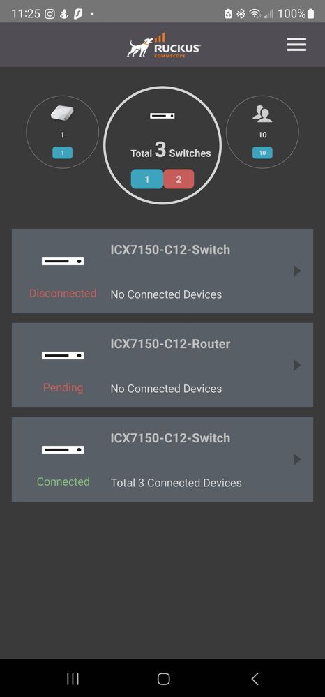

11-02-2023 11:33 AM
It is finally working... I think. In the Unleased app it shows that I have 3 ICX7150-C12- switches (see image). Also, it connects to a SSID that I had used on the ICX7150-C12 switch that was replaced with the new refurbished one. Which is not correct. The router SSID is ASUS_98_2G or ASUS_98_5G, not Dallas, whcih appeared instead of ConfigMeXXXXX.

11-03-2023 11:13 AM
I'm sorry I don't understand what you're suggesting Imaran. I only have 1 AP and 1 switch. Why would the replacement switch have the prior SSID of "Dallas" instead of "Configure.Me-XXXXX"? You also say to "disconnect other AP's". I don't have any other AP's. My question is. Why is Unleased showing 2 other switches totaling 3 when there is only the refurbished 1? And lastly.... how do I change to the SSID of the real router SSID of ASUS_98_2G or ASUS_98_5G, and not "Dallas"? I just want the ICX7150 to see and connect to router ASUS_98_2G or ASUS_98_5G and remove the ghost ICX7150's that are not connected. All the AP LED's are displaying green with the exception of "air" in the middle. Hope that makes sense.
