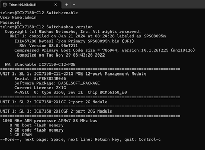

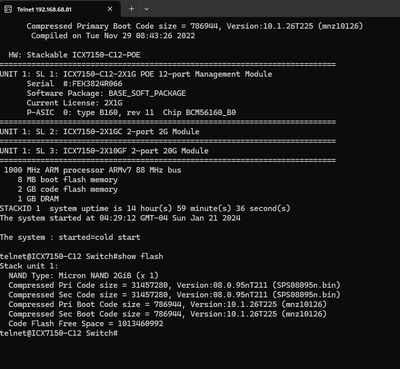

We have noted that the switch version has been successfully upgraded to a UFI version, as evidenced by the screenshots you shared.

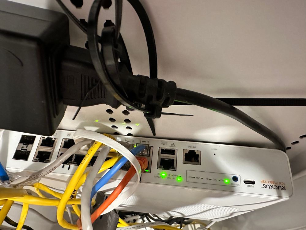

1. When the switch is plugged into the outlet, do you observe any indicator lights (amber or green)? Please describe which lights are illuminated. Additionally, we kindly request that you share a picture showing the status of these lights and the complete cable connections to the switch ports.

3. Could you please confirm how many Access Points are currently connected to the switch? Additionally, we would appreciate it if you could provide the status of the indicator lights on these Access Points. Kindly share a picture displaying these lights for our reference.

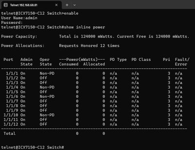

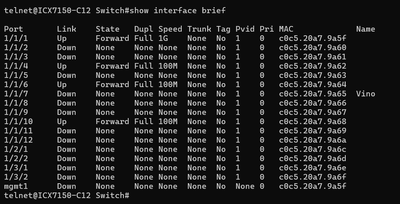

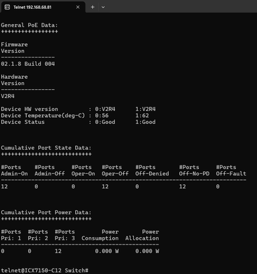

We may need to check some configurations on your RUCKUS Switch. Could you please share a outputs of the below commands:
After successfully accessing the CLI, please execute the following commands and provide the outputs:
   show inline power
   show inline power detail
   show interface brief
   show ip address

Sure, Please see below:
end.
