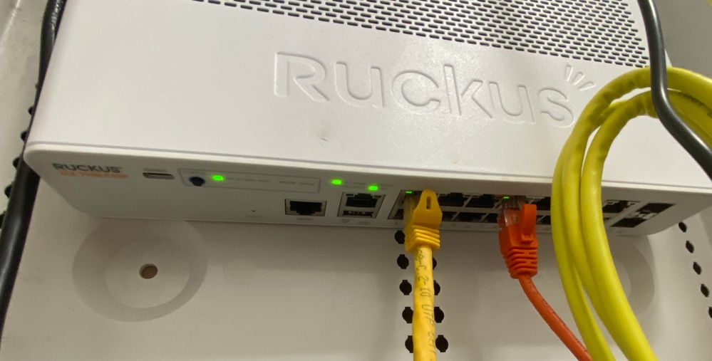

2. On your switch while it's plugged into the outlet, do you see any lights on? (Amber or green) Please let us know which lights are on. (Please refer to the below picture and share a picture of the same, showing the light status and the FULL Switch panel cable connections to the Switch ports)

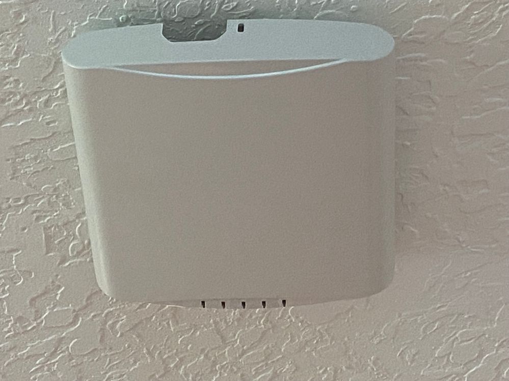

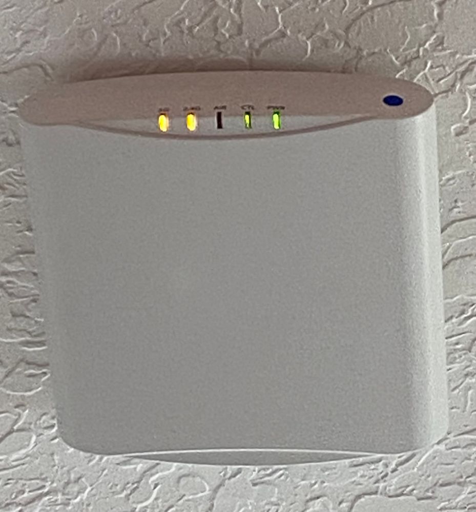

4. May I know how many Access Points are connected to the Switch? Could you please let me know the light status on the Access Points? Any of these lights are on (Please refer to the below picture and share a picture of the same)
Good morning, hope you are doing great!!!
1. Yes, it was working fine. I think that maybe there was a power outage before it stopped working.
2.  Green and Orange lights are on.
3. Yes, Internet is working.
4. No lights on.

Hi @jannyvalentin
As I can see from the picture you shared, there are lights on PWR and SYST, if there is an amber/orange light on the "SYST" and a green light on the "PWR" on the Switch (as it is in the below picture). Meaning the Switch is stuck in the boot mode.
Basically, due to the power outage/ power spike, the switch went to a state that we call โ€˜boot modeโ€™ that is not able to boot up properly.
As you mentioned that you tried reset, once again we will try to reset the Switch as described below:
  • Remove power from the switch.
  • Press and hold the Reset button while applying power to the switch.
  • After all the system LEDs flash amber, release the Reset button.
IF RESET IS NOT WORKING, PLEASE TRY TO RESET YOUR SWITCH MULTIPLE TIMES (Like 10-15 times) AS DESCRIBED ABOVE.

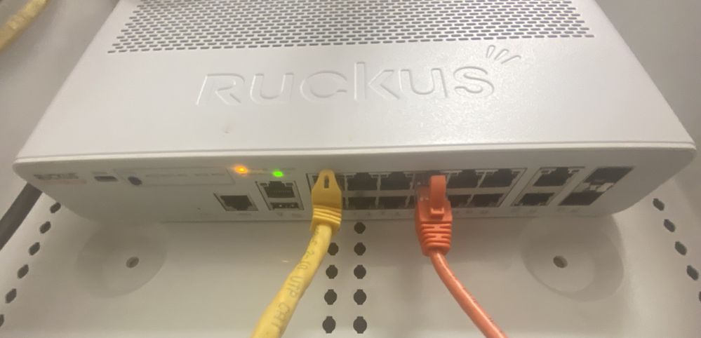

Greetings,
Thank you for your help. We did it. This is how it looks now, is there something else that needs to be done?
Thank you
