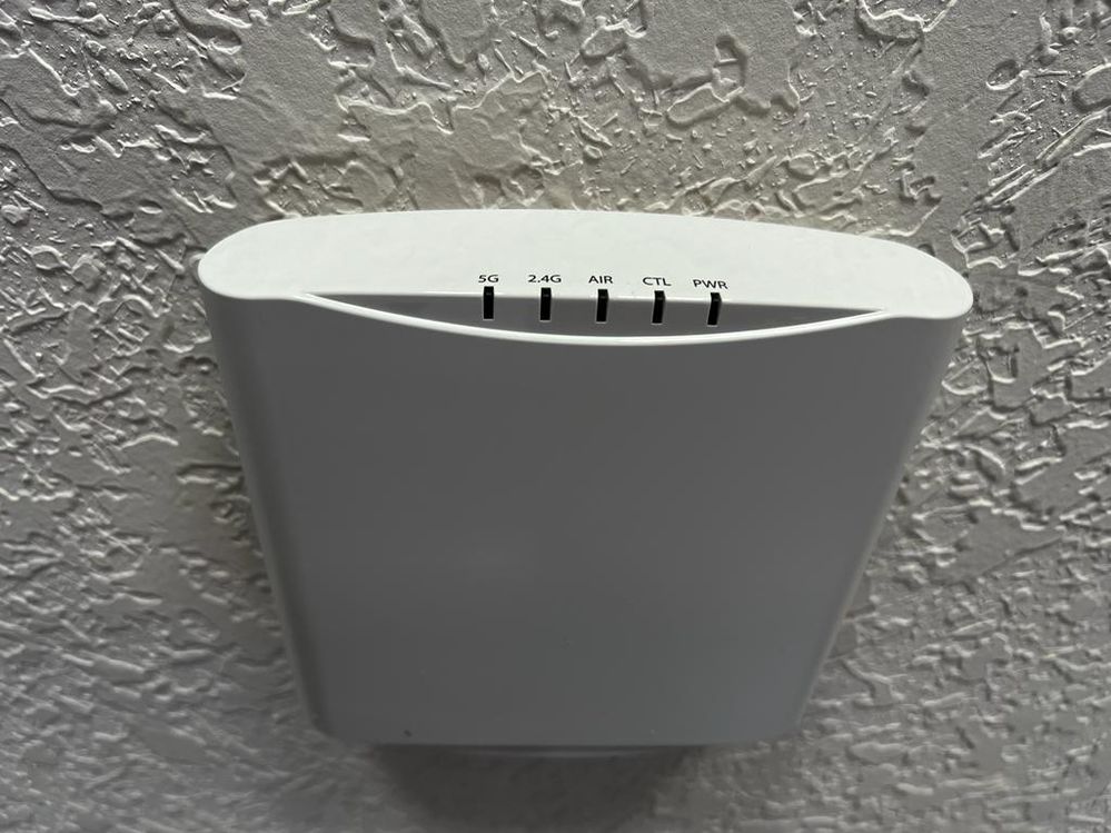

The rucks device suddenly stops working and all the access points are also turned off. I followed up on other messages, and try to solve it but had no luck, even Advanced IP Scanner is not able to find it on the network, I also tried to reset it but still nothing, it does not come on the network.

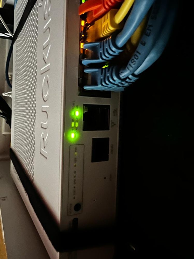

I can see Brocade Cummunications Systems LLC, seems like that is a part of ruckus. Please help me asap.

From the case description, I could understand that your RUCKUS Access Points have no power.
1. As you mentioned you have an IP Address from IP Scan with Brocade Communications, please use the same IP Address, try to access CLI, and help with the below-mentioned commands.
ICX7150-C12 Router> OR
ICX7150-C12 Switch>
show version
show flash
show inline power
show inline power detail
