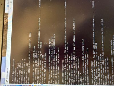

Based on the information provided, it appears that your RUCKUS ICX-7150-Switch is stuck in a boot mode.
To better assist you, could you please share a screenshot of the error you are getting currently during the Software Recovery process?

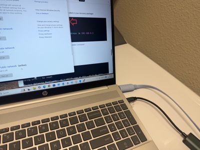

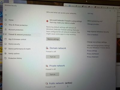

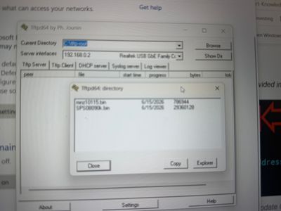

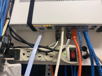

Hi Imran, thank for your quick reply. I am attaching the putty console log and connections. Please let me know if I need to do anything. Ping did not work for me, and I tried manual update option suggested at the end.

Hi @svmanne

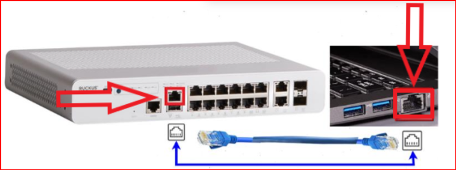

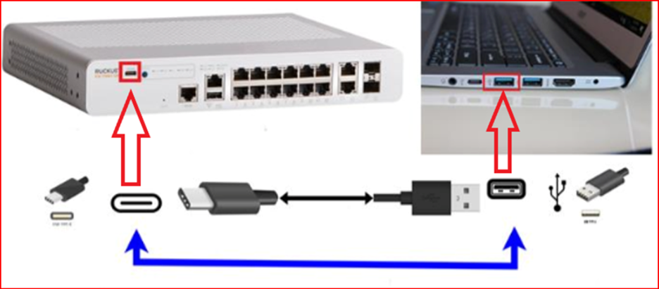

From the picture you shared, I noticed that cables are connected incorrectly. Please connect them as shown in the Software Recovery article. Please note that both connections are required for the recovery process:
One Ethernet cable (RJ45 to RJ45)
One USB-to-Type-C cable
(Refer to the screenshot below.)
Kindly connect both cables simultaneously and perform the Software Recovery process again.
Please let me know if you have any questions or need assistance at any step.

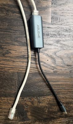

My laptop does not have a network port, can I use network port to usbc adaptor on the laptop side as shown below?
