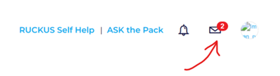

To initiate the replacement, Please use the private chat option to respond so we can proceed further. For your reference, I have included a screenshot below.
