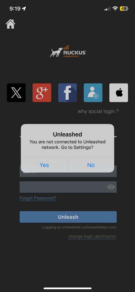

Hi Pinky,
Yes, I still cannot log in to my AP. I get the following prompt below when trying to log in on the app via my iPhone. I tried all the combination above that you listed and none worked. I tried the default that is on the AP, and also does not work. When I try to log in via the web browser on my laptop, the "unleashed.ruckuswireless.com" cannot be reached. I try logging to the AP IP, and I get the same notification that it cannot be reached.
When I click "yes" under Setting option, there's essentially no configuration option. Just provides option setting for "Location", "Local Network", "Siri & Search", "Notification", "Background App Refresh', and "Cellular Data".
I read something about needed to updated the firmware for the AP, and but I would need to log in to the AP, which I cannot do right now.
