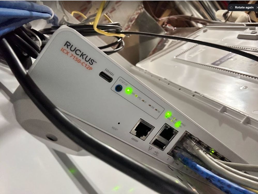

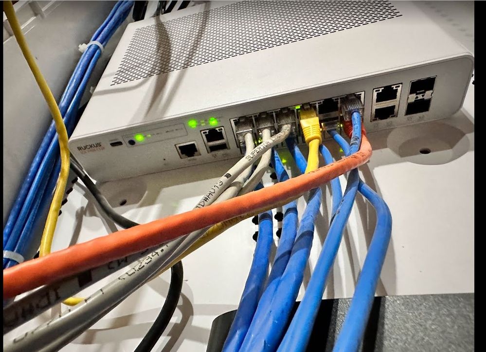

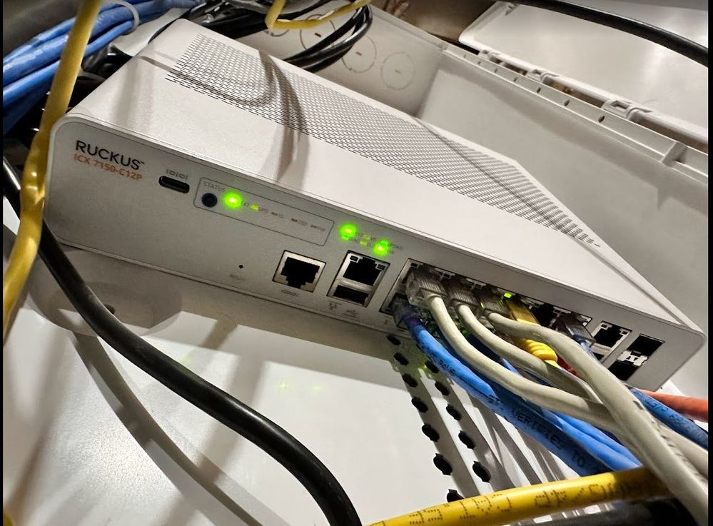

2. On your switch while it's plugged into the outlet, do you see any lights on? (Amber or green) Please let us know which lights are on. (Please refer to the below picture and share a picture of the same, showing the light status and the FULL Switch panel cable connections to the Switch ports)

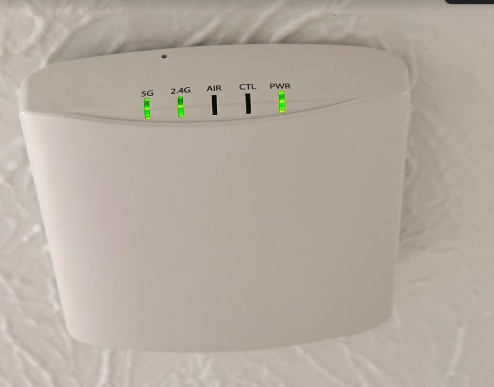

3. Could you please let me know the light status on the ALL the 3 Access Points? Any of these lights are on (Please refer to the below picture and share a picture of the same)

Hi @hareshoad
As per the pictures, RUCKUS Switch and Access Points lights status are normal in it's behavior.
This issue may happen when the Switch runs on the Routing code (SPR). The Switch should run on the Switching code (SPS) to avoid these issues for Lennar home users. If the Switch boots up on the other partition (Due to a power outage/power spike) which may be running on a ‘Routing Code’ results in causing this issue. To check the same please follow the below process.
