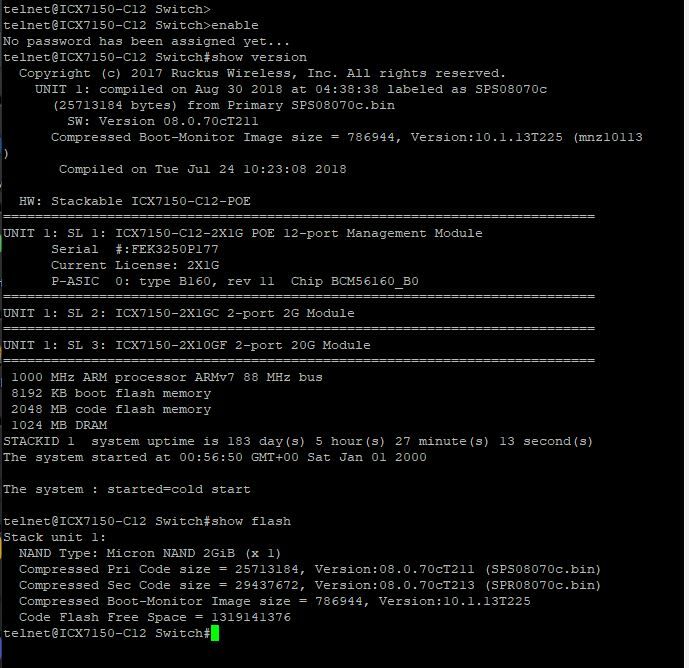

Hi @Nstars07
Thank you for the update and the information you shared.
Please check and confirm once if same version is copied on both the partitions and share the same.
show version
show flash

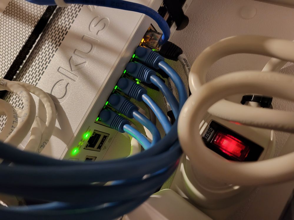

1. On your switch while it's plugged into the outlet, do you see any lights on? (Amber or green) Please let us know which lights are on. (Please refer to the below picture and share a picture of the same, showing the light status and the FULL Switch panel cable connections to the Switch ports)

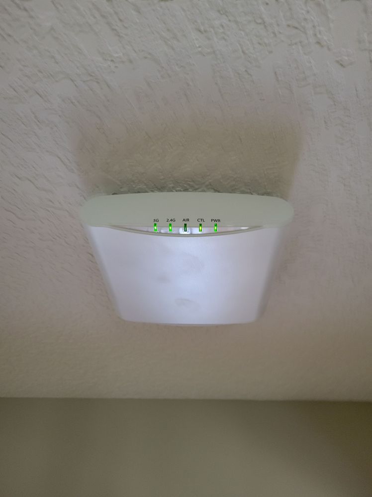

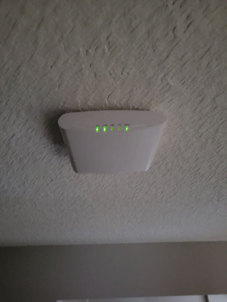

3. May I know how many Access Points are connected to the Switch? Could you please let me know the light status on the Access Points? Any of these lights are on (Please refer to the below picture and share a picture of the same)
Nstars07
All of my lights are green and good to go.  My internet is working perfectly for my hardwired desktop.  Again, it will all be green and working fine and then the AP's 5G will turn orange and I lose the connections.  I change nothing and within 3-20 minutes (random time) it comes back on and things reconnect.  I have attached my photos.20230804_135019.jpg20230804_134929 - 2.jpg20230804_134757 - 2.jpg20230804_134821 - 2.jpg
Hi @Nstars07
We will check some configurations on the Switch, please follow the below steps to check the same. And help us with the command outputs.
ICX7150-C12 Router> OR
ICX7150-C12 Switch>
show version
show flash
Lennar Home Community.
