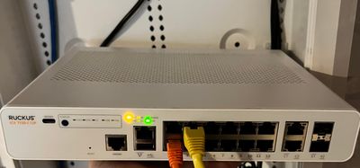

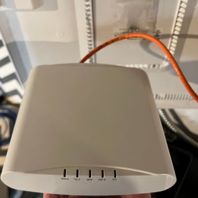

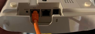

See the attached photos you requested. The switch has amber and green illuminated and none of the status lights at the access point are illuminated. I only had this one access point connected and it was mounted to the ceiling on our main floor. (Switch and Modem/Router are in basement).

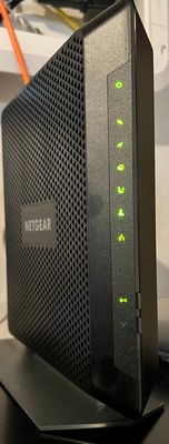

The internet from our ISP works great (yellow Ethernet). I replaced our Xfinity gateway with a NETGEAR Nighthawk Modem/Router C7000v2 without any connectivity issues.

As you mentioned and we can see from the pictures you shared there are lights on PWR and SYST, if there is an amber/orange light on the "SYST" and a green light on the "PWR" on the Switch (as it is in the below picture). Meaning the Switch is stuck in the boot mode.
Basically, due to the power outage/ power spike, the switch went to a state that we call ‘boot mode’ that is not able to boot up properly.
As you mentioned that you tried reset, once again we will try to reset the Switch as described below:
  • Remove power from the switch.
  • Press and hold the Reset button while applying power to the switch.
  • After all the system LEDs flash amber, release the Reset button.
IF RESET IS NOT WORKING, PLEASE TRY TO RESET YOUR SWITCH MULTIPLE TIMES (Like 10-15 times) AS DESCRIBED ABOVE.
