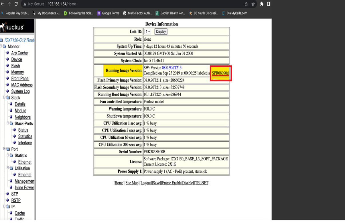

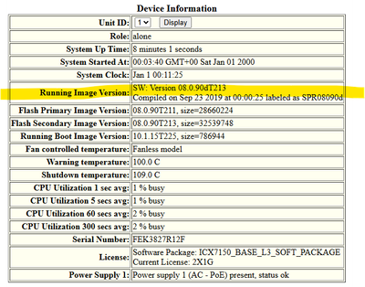

Hello @ANG1883 ,
I understand that you are unable to access CLI; however, were able to login to GUI of the Switch through web browser.
Please refer to the below screenshot and share the running version of the Switch if you are unable to share the screenshot.
Hello @ANG1883 ,
This issue is because your switch is running on the Routing code (SPR). The Switch should run on the Switching code (SPS) to avoid these issues for Lennar home users. Due to a power outage/power spike, the Switch boots up on the other partition which may be running on a ‘Routing Code’ results in causing this issue.
Please follow the below RUCKUS Lennar Knowledge base self-help article which will help you to fix the issue when the Switch is running in the Routing code through GUI.
https://community.ruckuswireless.com/t5/RUCKUS-Lennar-Support-Knowledge/Title-Fixing-RUCKUS-ICX-7150...
Please follow the process as explained in the article and let me know if you have any queries in this regard.
I followed the steps you have outlined but the image below keeps flashing... Where the "YELLOW" is my IP Address.
