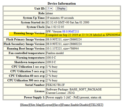

I believe I have corrected the issue with my iPhone and "Termius" App that I downloaded. I haven't fully tested to see if everything is working properly but at least things are loading on my phone and music is playing through my Alexia (which it wasn't doing either before)
As you can see below, the "Running Image" is now referencing "SPS" but the version 08.0.90d... Should I still change this version to 08.0.90e as referenced above or leave as is?
