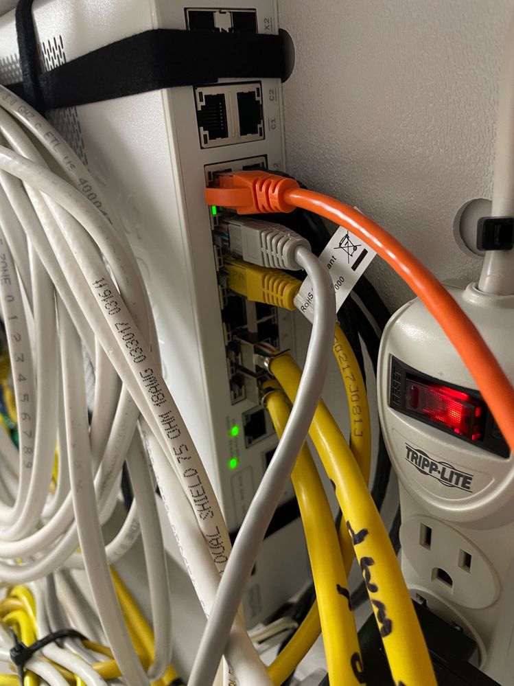

I am new to this community and my AP is not powering up since a month. I have bought the Another Router and working on it. Could someone provide the technical support how to troubleshoot the Access Points. Thank you and Appreciate the help.

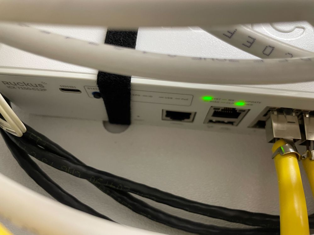

1 -Is the Access Point powering up via Power injector ( external power to power the Access Point ) or Ruckus switch if the answer is ( Ruckus switch ) could you please answer the following questions ?
2-On your switch while it's plugged into the outlet, do you see any lights on? (Amber or green) Please let us know which lights are on?
2-Make sure it is plugged into a well-known outlet/power source

Seems that you switch may present some PoE issue (power over Ethernet)

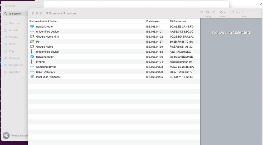

1-For this we must locate the IP address of your Ruckus Switch (this is a logical address assigned by your local router (ISP) to the switch) I will leave a quick guide:
2-After that we must remotely access to device, I leave a guide on how to access to the switch
Here is a quick guide how to access via CLI of the devices
If you can access to the Command line should look like this
