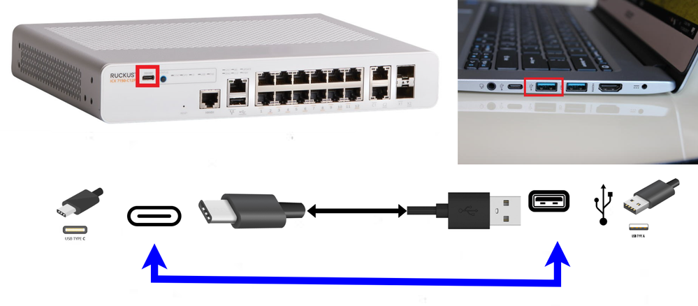

Please advise what to do if COM3, COM4, or any other com does not work. I only get com3 and com4 in port in device manager and both are some bluetooth enabled and do not look like the one in your example

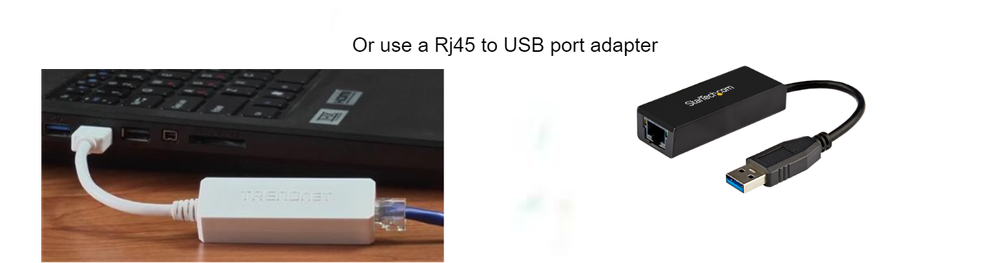

BTW I am using a USB-C to eternity adapter to connect to the ethernet port
Hi  @groshon8
For console access ( to access to the CLI command line for the ICX-7150 ) the cable should be ( ICX - 7150 C12 P ) USB type C to USB  ( PC ) as the below on the picture :

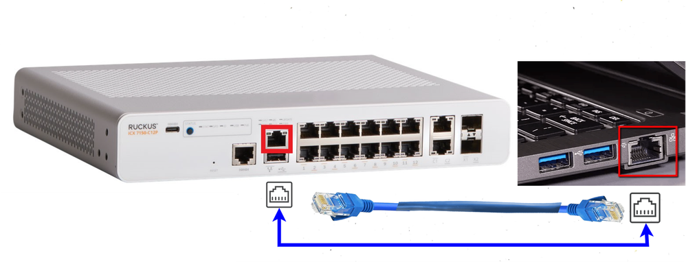

That Step is only needed to get access to the Command line for the Switch the next step is to get data ( between the ICX and  PC )
If your PC does not have an Ethernet port you can use an adapter  :
That step it was for data transfer ( both steps are needed it to complete the software recovery process )
