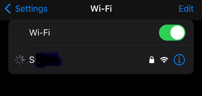

Hi Imran,
I followed steps and could able to reset the network with new username and psw. unfortunately none of my devices are connecting to netwrok
Here are some pictures for your reference:
1. Phone is keep connecting to wifi but never completes the network
