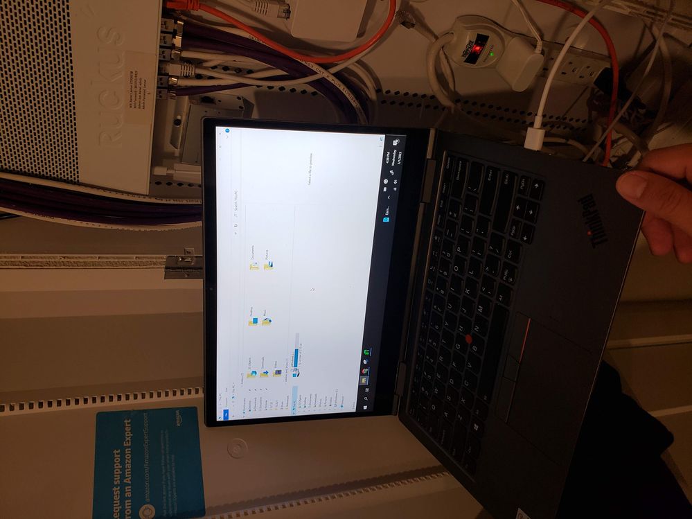

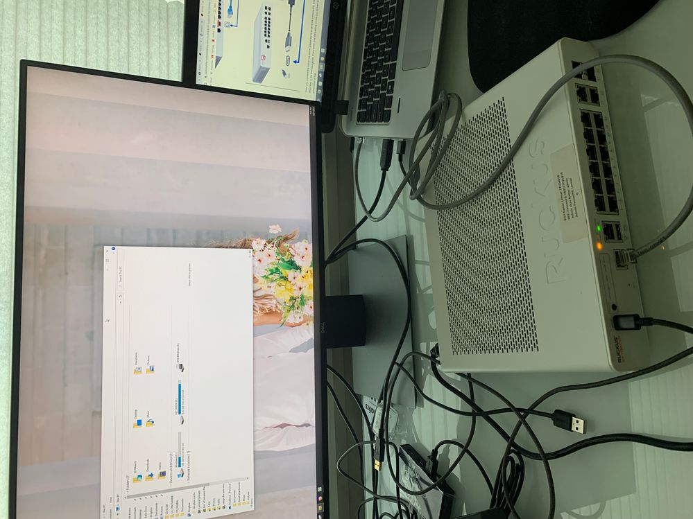

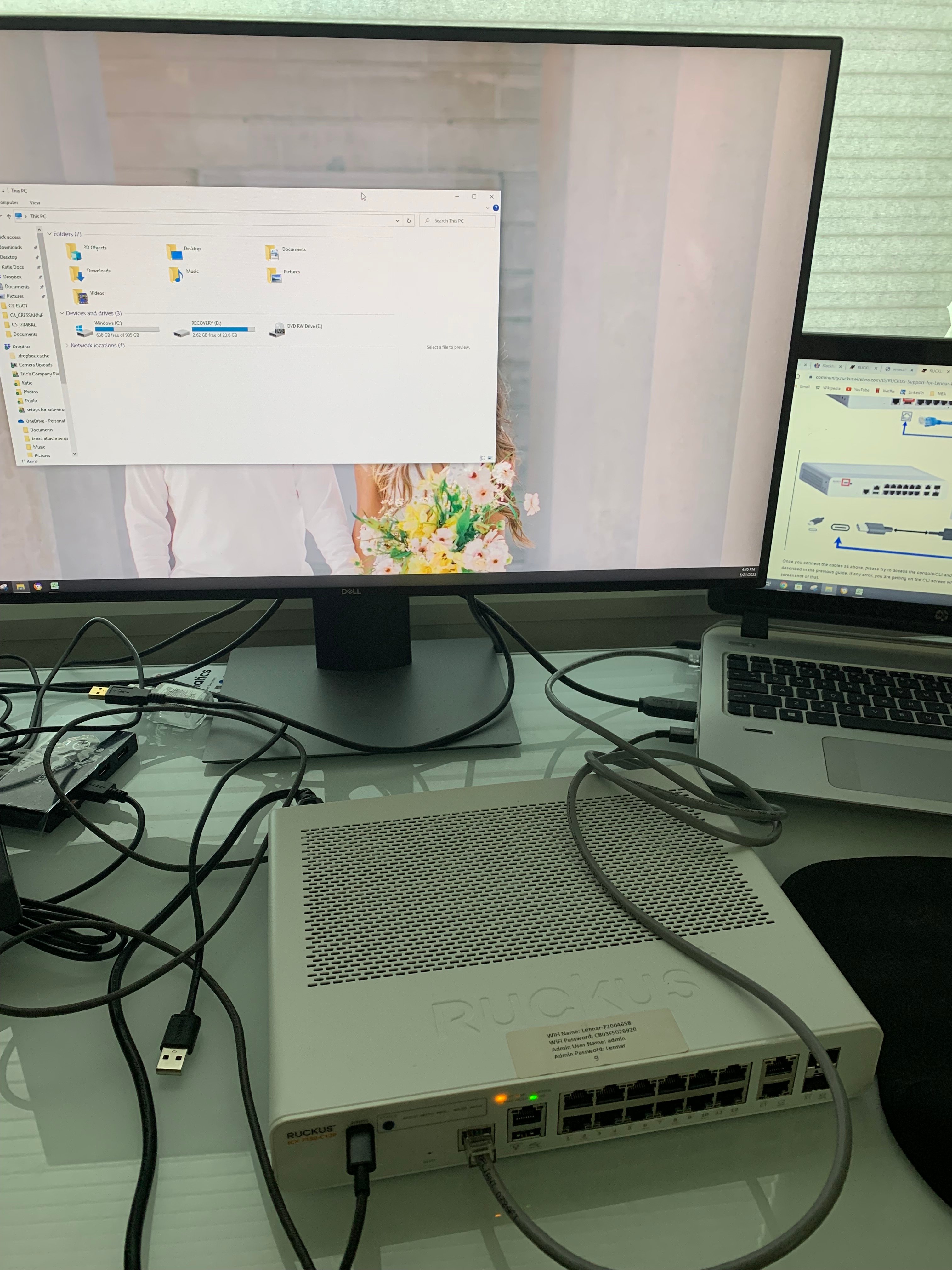

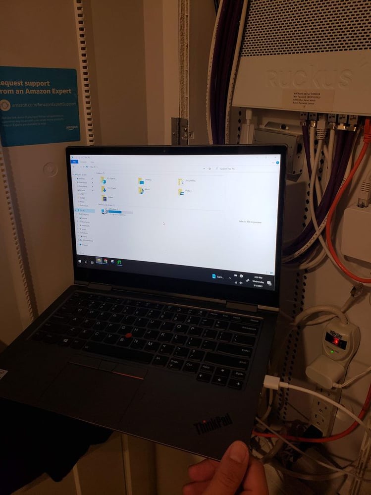

To summarize, my switch no longer works after a power outage. It's been 3 months and I have not been able to get this troubleshoot to work. Can someone please help send a replacement switch? With my laptop I cannot download the necessary software, and I have all connections aligned but cannot proceed further. This has been a frustrating process and hope that the support team can assist

As I see from the screenshot, you have only used an ethernet cable to USB for the software recovery process and it is plugged into the incorrect port on the Switch panel. It should be plugged into the correct port as marked in the screenshot below. Please use ethernet cable (both ends RJ45 plugs) and USB to type C cable both together as described in steps 2 & 3 in the guide link. Request you follow the same and perform the software recovery process once again.
