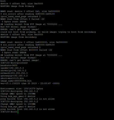

Power Outage and now no Wifi is working in the house. Yellow system light is ON the Ruckus 7150 switch and green power light is ON. Hardwired ethernet connections are working in the house so assuming there is a connection from service provider and its the RUCKUS switch.
I tried connecting remotely with no luck and was able to connect directly to console with USB to C connector and Putty terminal (serial connection). I don't get a login request but the first thing that comes up is "ICX7150-Boot>".
Does this mean I need software recovery? If this is the case, I'm confused by the other posts to even understand what I would need to do next. Also, command like "enable" etc. in other posts do not work in my terminal commands.

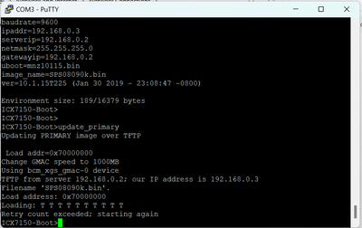

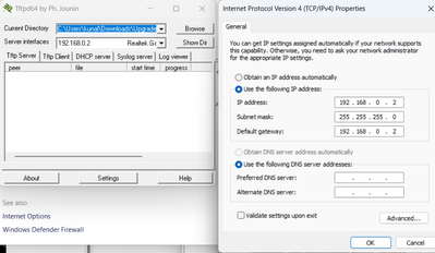

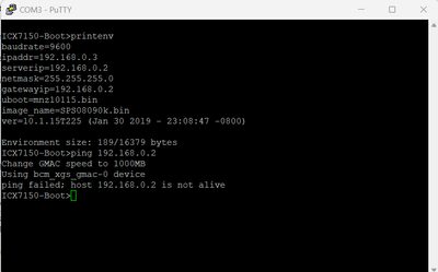

 I set the switch IP 192.168.0.3 and even tried others. My computer I used 192.168.0.2 for the computer IP and I even restarted my computer before connecting to the switch to ensure that my computer static IP stayed the same.
Not sure how to get connection to the switch to update.

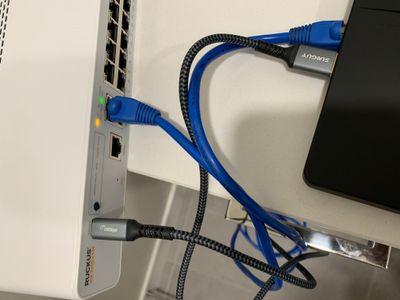

 Picture of connections. I tried 3 ethernet cords, and 2 usb to usb c adaptors (data transfer). None of this changed the outcome.

Based on the troubleshooting done, seems that the management port is not  responding  this unit should be RMA (return merchandise authorization) in simple words replace it.

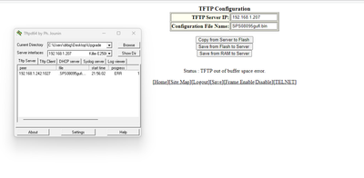

I received my new switch. I am trying to upgrade it via the Web GUI method and keep getting this error:
