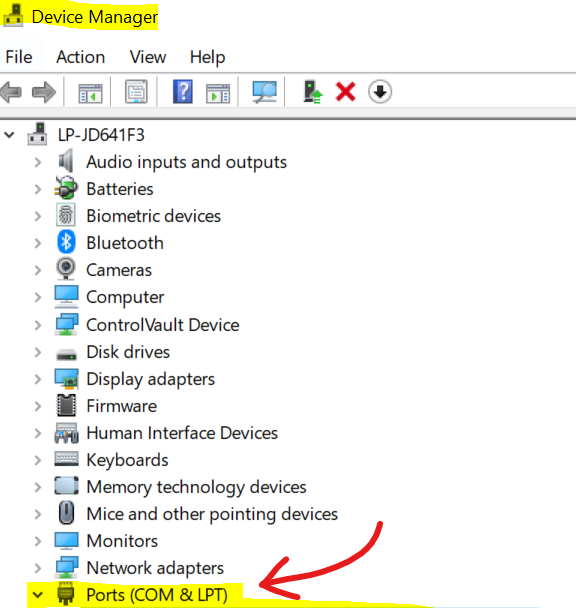

Please follow the below steps:
1. Once again, Please make sure to download the zip drive for the file below & "extract all". Once it's extracted, run the file, the driver should be installed using the 2 links below.
Link 1: https://support.ruckuswireless.com/software/1414-brocade-ruckus-7150-usb-serial-driver-windows
Link 2: silabs.com/developers/usb-to-uart-bridge-vcp-drivers?tab=downloads
Once installed restart your laptop and try to locate the COM port details under 'Ports (COM & LTP)' with cables connected between the Laptop and the Switch (Refer to the below screenshot), The COM port name for the RUCKUS Switch must be 'Silicon Labs.
Please let me know if you have any queries.

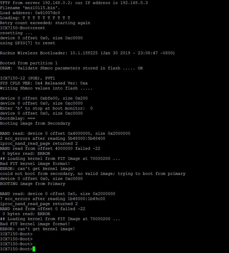

Thanks for your help. I installed the driver and performed the steps in Putty. Still I see the color as amber.
03-13-2025 06:33 AM
My device is showing 'not alive' even after turning after the firewall. So, I followed these steps.
03-13-2025 06:50 AM
