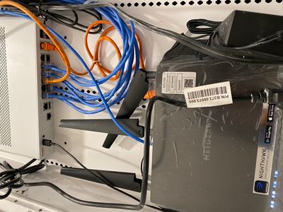

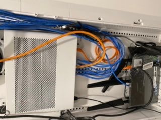

I confirmed no power to APs on any ports after extended shutdown and factory reboots. I also went and tried to change the coding but that still didn’t work. The status is amber and the power light sits in green. After resetting to factory default settings the lights simply just flashes yellow.
After that I followed other instructions through another community member engineer response and I have had no luck.
This is the third time that this has occurred. The last time this happens about 6 months ago they were going to replace it, but the engineer person at the time was able to tap into my laptop and reconfigure the coding. He struggled but kept trying and things went back to normal. The crazy part is, this time I did not have a power outage.
What are my next steps?
