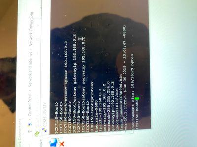

01-03-2023 04:26 PM
I’m not understanding where I go from here…….does this look correct?
