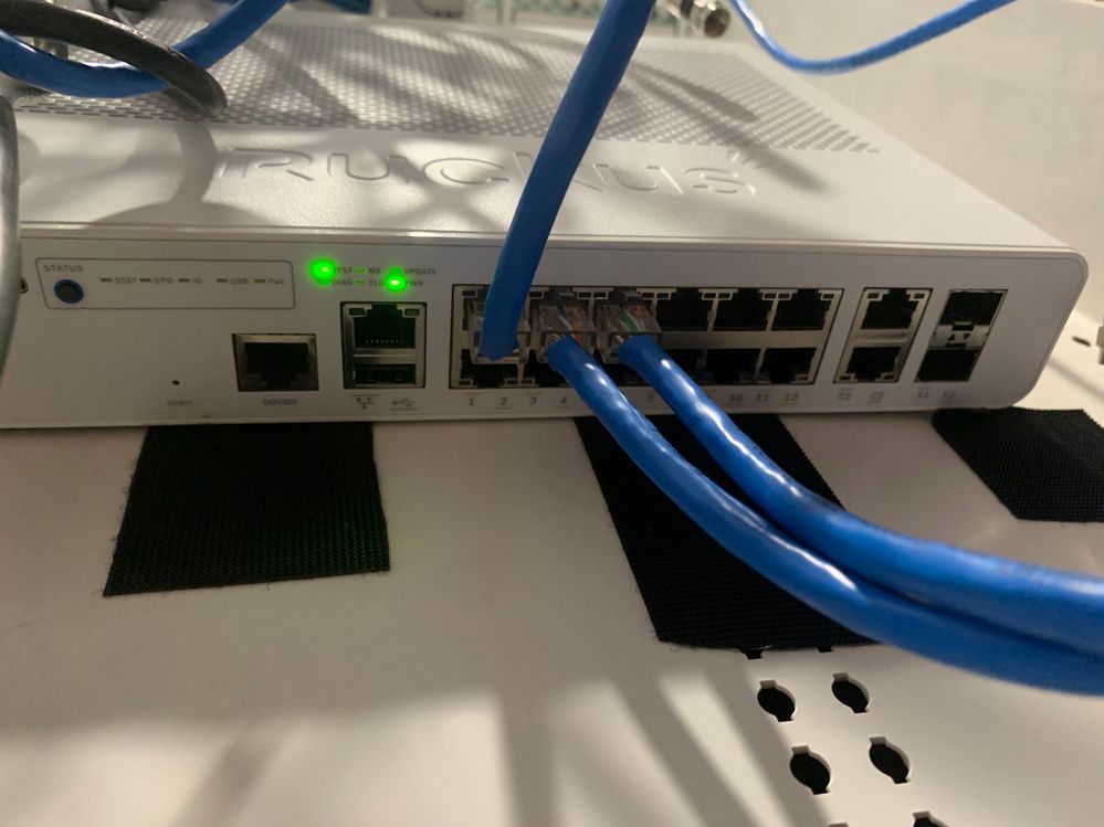

1. On your switch while it's plugged into the outlet, do you see any lights on? (Amber or green) Please let us know which lights are on. (Please refer to the below picture and share a picture of the same, showing the light status and the FULL Switch panel cable connections to the Switch ports)

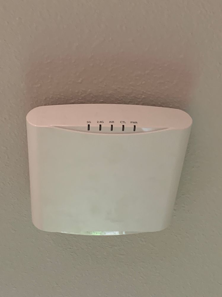

3. May I know how many Access Points are connected to the Switch? Could you please let me know the light status on the Access Points? Any of these lights are on (Please refer to the below picture and share a picture of the same)
Thank you for getting back to me. Here are answers to your questions and pics below:
1) yes, two lights are on and can see locations in the pic below:

3) I have 3 access points/R510 connected. All 3 do not have any lights on and all stopped working at the same time.

As I can see from the Picture you shared, there are only 3 Access Points ethernet cables are connected to your RUCKUS ICX-7150-C12P Switch. There should also be a ethernet cable coming from your ISP (Internet Service Provider) Router/Modem-Router Combo must be connected to any 1 in-12 ports (as highlighted in the screenshot below).
Please check and let us know if you have any queries in this regard.
