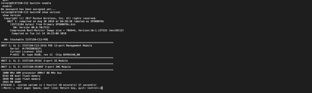

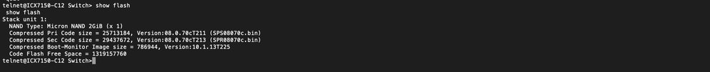

The Switch version should be on or after 08.0.90. If you have CLI access, please share the below commands output to check the same.
show version
show flash
03-11-2024 12:24 PM
@Imran_ruckus:
Please find requested command outputs below
03-11-2024 12:49 PM
Hi @ynv_naw
Thank you for the response and for sharing the requested information.
I see your Switch is on an old non-UFI 8070c version (please refer to the below screenshot). That is the reason your RUCKUS Switch is not getting listed in the Unleashed system.
