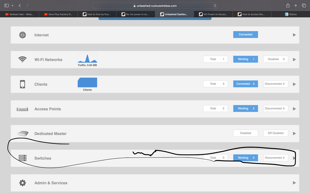

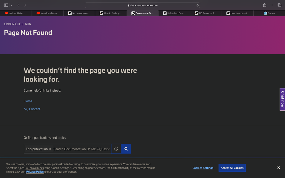

The provided link does not work so I reboot the switch and it caused more issues. The downstairs access point went back down so I had to go back through the steps using the command link. Turns out there are two bad ports as the cable was not being powered on with the two ports I put the cable in. It is now on after moving to a 3rd location. What is the cause of this? Could you provide another link to add the switch to the unleashed ruckus dashboard?

Hi @ynv_naw
If the link is not working please refer to the below screenshot to enable the same.

@Imran_ruckus:
I have completed this step and the switch still does not show on the dashboard
