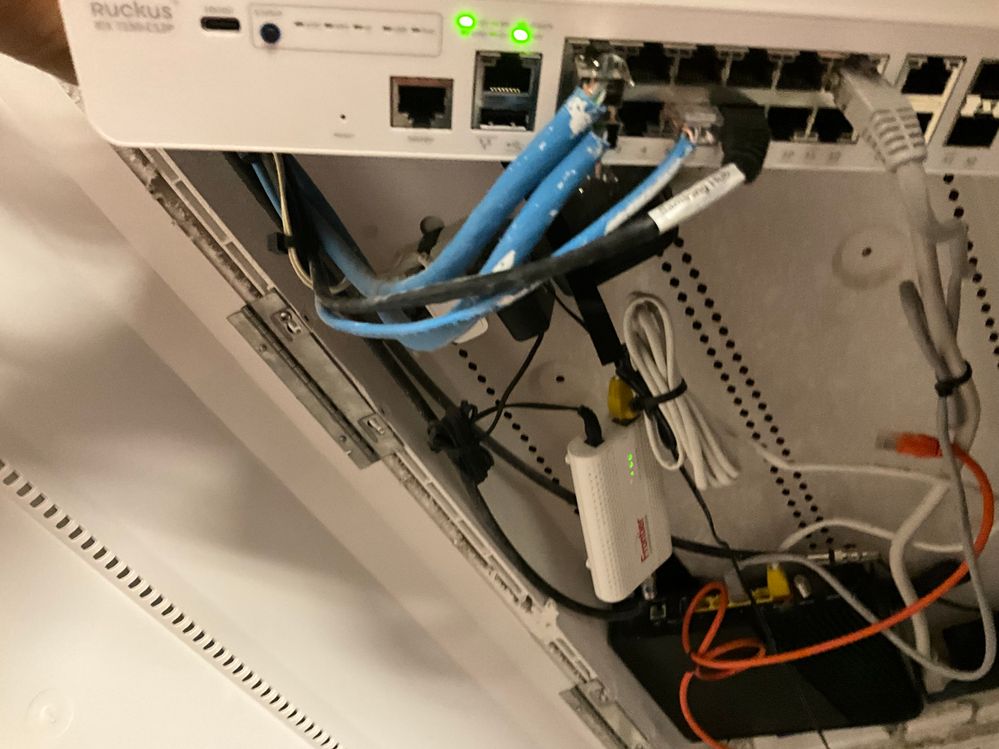

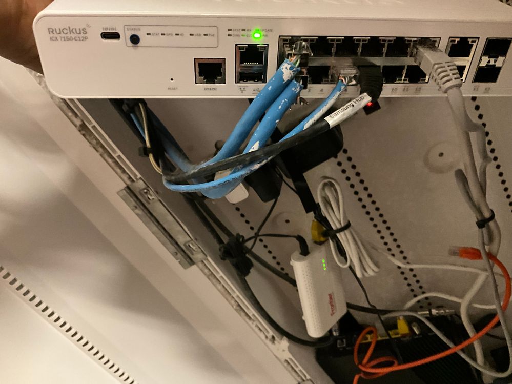

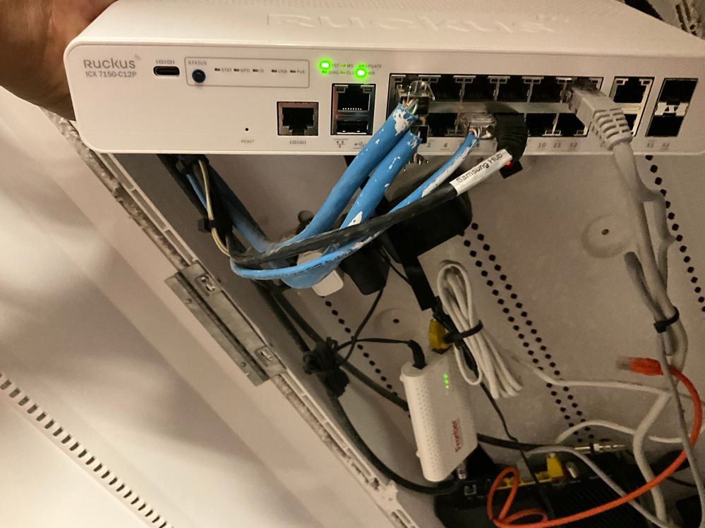

Hello @MrG6872
As per the case description, I understand that your RUCKUS setup is not working, and Access Points do not have power.
1. Was there any power outage before you started facing this issue?
2. On your switch while it's plugged into the outlet, do you see any lights on? (Amber or green) Please let us know which lights are on. (Please refer to the below picture and share a picture of the same, showing the light status and the FULL Switch panel cable connections to the Switch ports)
3. May I know how many Access Points are connected to the Switch?
