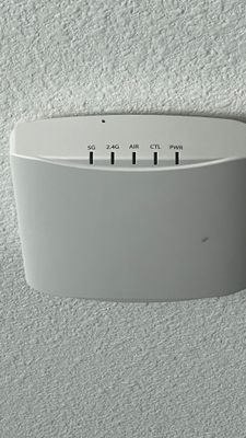

-I’m in a Lennar home Canopy Grove Escondido, CA.
-cant access the switch since power outage.
-ICX 7150-C12P with 2 wireless access points.
-no power or lights on both access points.
restart of power didn’t change anything.
08-14-2023 10:30 AM
EVERY light on both AP’s are out. It’s blank. Nothing is lit up.

Status lights have been flashing for 10 minutes after I released the reset button.
still no lights on AP’s
