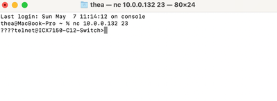

Once you said I had to go to the terminal I was able to google how to do that. Maybe you can take baby steps with me since you don't provide telephone support and all we have is this forum.
Went to the terminal and typed in the IP address like you said. then typed enable. Now I'm not sure what to do. What's next...I have one green light and two orange on my access points. So we are making progress.

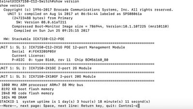

show version

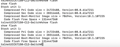

show flash
show inline power

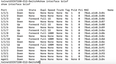

show interface brief
Screenshot 2023-05-19 at 12.30.37 PM.pngScreenshot 2023-05-19 at 12.31.23 PM.pngScreenshot 2023-05-19 at 12.31.50 PM.pngScreenshot 2023-05-19 at 12.32.23 PM.png

Thank you for the response and sharing the requested information.
Based on the output of the commands Switch seems to be in a normal condition.
Please try to reboot the Switch by performing the below commands and check the connectivity once it comes up after some minutes.
Below are the commands:
