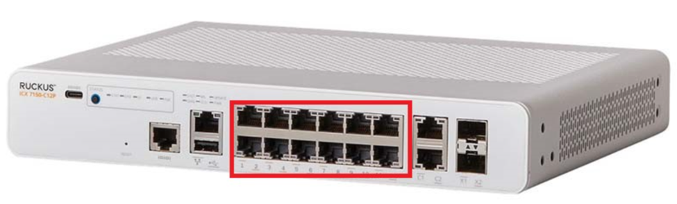

Could you please unplug the ethernet cable connected to the affected AP/Extender from the RUCKUS ICX-7150-C12P Switch and plug it back into any other available 12 ports (1–12)?
(Please refer to the screenshot below for guidance.)
Once done, check if the extender powers back on.
Please let me know how it goes.

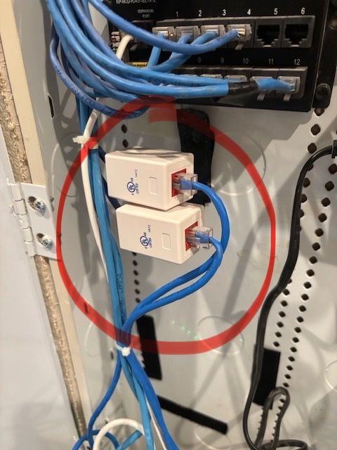

Hi! thank you for your quick response. I don't have a "RUCKUS ICX-7150-C12P"  But, are these 2 white blocks (encircled in pic attached) dedicated to the 2 ceiling mounted wifi extenders?
If so...I have followed them into the AT&T wifi Gateway and plugged them into open ports of the router...and the lights on both WiFi extenders were still off.
wifi extender plugs?wifi extender plugs?

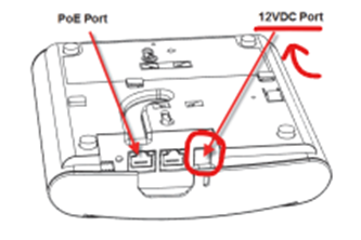

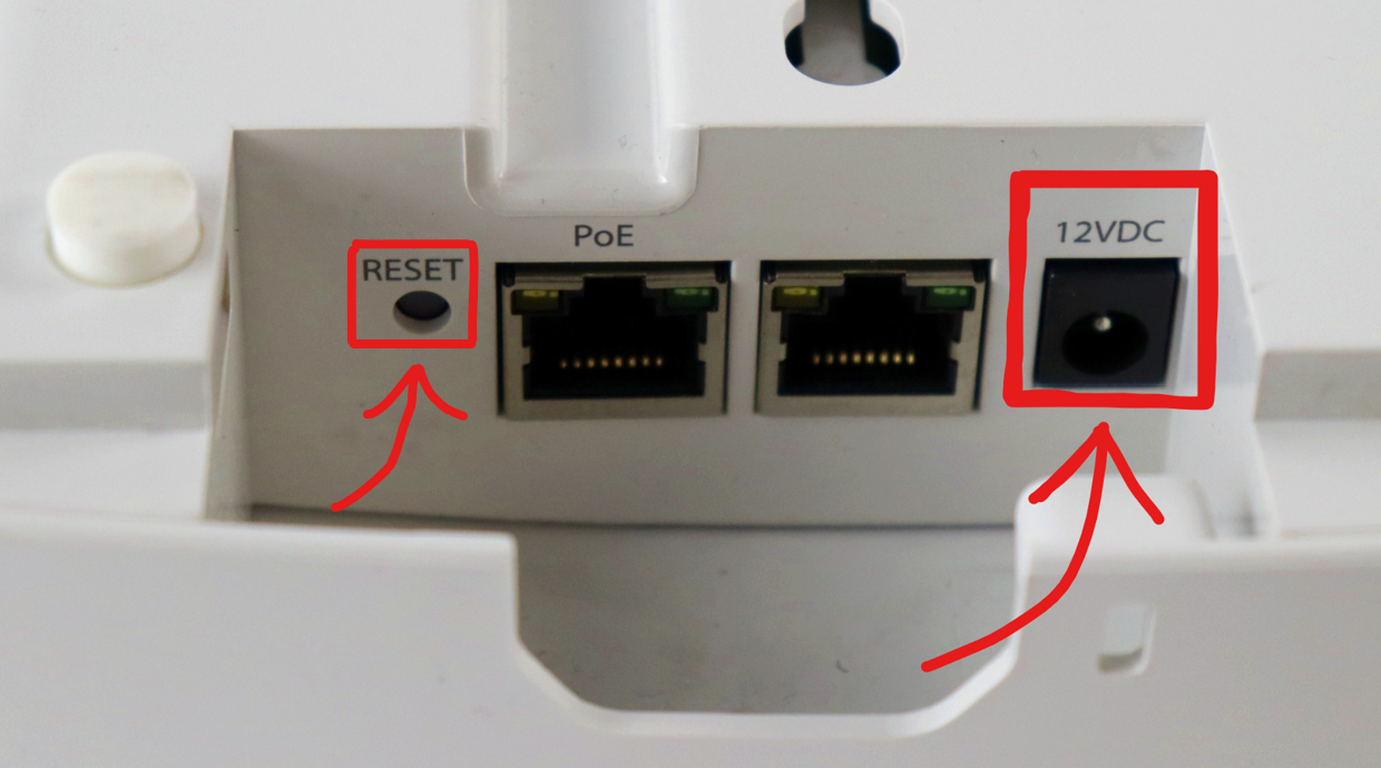

Could you please take the affected Access Point off the ceiling and try performing a factory reset using a paper clip? For this process, please ensure that the unit is powered only by a 12 VDC external power adapter and NOT connected via the PoE (Power over Ethernet) switch cable. (Refer to the Screenshots below)
Usually, you will find the 12 VDC adapter connected to your ISP’s Router/Modem-Router combo device.
For your convenience, here are the instructions and helpful resources:
