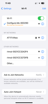

I have had my ruckus system for > 2years when the Lennar home was purchased.
Everything was functioning properly but about 2 days ago the wifi stopped broadcasting.
I turned the system on and off a few times and reset the system. It would now broadcast but continued to have "no internet connection" when connected and reconfigured.
I have checked (and changed) connections from the modem to the router. The ISP is functioning properly (AT&T fiber and has a modem/router setup -- has a separate wifi which is functional).
The ruckus router lights are on PWR, STAT, SYST
3 access points have power green and flashing green for CTL
I reviewed other forum messages regarding this.
after connecting to the wifi and connecting to the unleashed.ruckuswireless.com I do NOT see any message stating that there are any updates to be installed.
also I'm on a Mac and I did not see support for putty on Mac.
thanks for the help!

see my screenshot from above. Unable to connect and configure the WiFi
Samrat
I’m sorry but are you reading my posts? It is reset and I cannot connect.
Refer to the screenshot above — connected to WiFi but giving me errors
