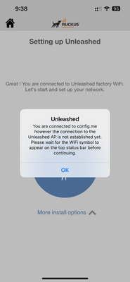

I have had my ruckus system for > 2years when the Lennar home was purchased.
Everything was functioning properly but about 2 days ago the wifi stopped broadcasting.
I turned the system on and off a few times and reset the system. It would now broadcast but continued to have "no internet connection" when connected and reconfigured.
I have checked (and changed) connections from the modem to the router. The ISP is functioning properly (AT&T fiber and has a modem/router setup -- has a separate wifi which is functional).
The ruckus router lights are on PWR, STAT, SYST
3 access points have power green and flashing green for CTL
I reviewed other forum messages regarding this.
after connecting to the wifi and connecting to the unleashed.ruckuswireless.com I do NOT see any message stating that there are any updates to be installed.
also I'm on a Mac and I did not see support for putty on Mac.
thanks for the help!

07-25-2023 11:51 AM
Reset complete.
see my screenshot from above. Unable to connect and configure the WiFi

I’m sorry but are you reading my posts? It is reset and I cannot connect.
Refer to the screenshot above — connected to WiFi but giving me errors
