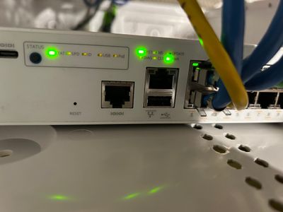

The ruckus router lights are on PWR, STAT, SYST

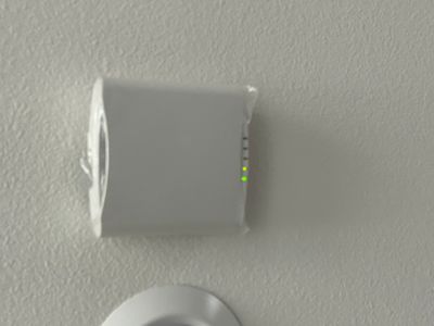

3 access points have power green and flashing green for CTL
