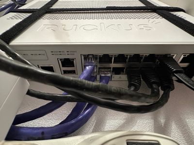

I am having the same issue as in my prior thread from July 2024. No power to my Ruckus ICX-7150-C12P. Last time, an engineer needed to remotely repair my Ruckus. Please help do the same. I cannot repair it myself.

1. Since it was last repaired in 2024, the Ruckus was operational until yesterday morning when I noticed it. I rebooted it and it worked briefly then stopped working completely.
2. None of the lights are illuminated and it is plugged in to power. The wires have been in the same ports since it was installed in 2018.

I have repeatedly reset the switch 20-25 times and it is not working. When I plug in the power cord while holding the reset button, the LED lights flash amber once then nothing lights up.
