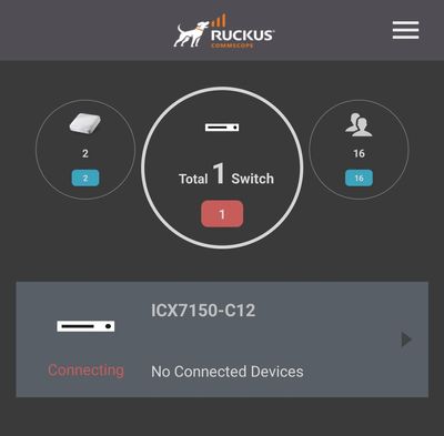

How do I connect the Ruckus AP devices after resetting the ICX150-C12. I have been having issues since a power outage occurred when I was out of town.
06-02-2023 10:51 AM
this is what I'm currently seeing and trying to resolve. Thank you.

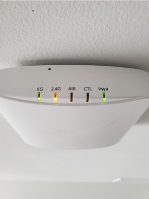

Hi @SG
Greetings of the day,
Thanks for the details provided.
Based on the description, the light on AIR is off and the light on the Radios 2.4 GHz shows Amber when the WAP is configured but no clients are connected to that specific radio or WAP.
Which means the radio signal is on, but you have no devices connected (phone, computer so ion).
To solve this issue please check the connection between the ISP router to the Ruckus ICX7150 Switch, because if this connection it's not working you will never get internet connection, just the AP will be powering up, because the Switch will provide power only. The yellow ports must be connected to your AP and your ISP router.

Unfortunately, there is no configure me option for me to try as the video sent describes. What would the next steps be?
