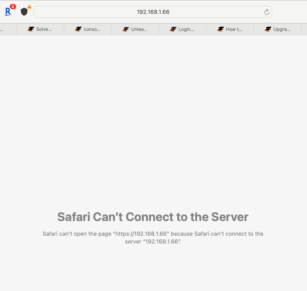

Hi Imram,
I tried that previously too. I keep getting error messages.
Hi @Clark
Please IP Scan once again and check it the RUCKUS ICX-7150-C12P Switch is assigned with a new IP Address.
I did that already as well. The scan shows it's the same IP address.
