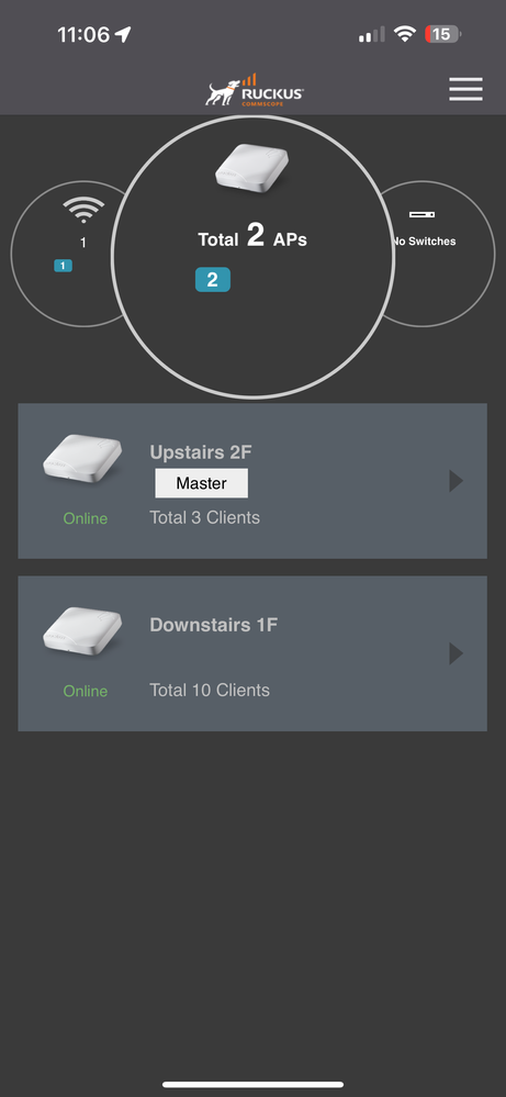

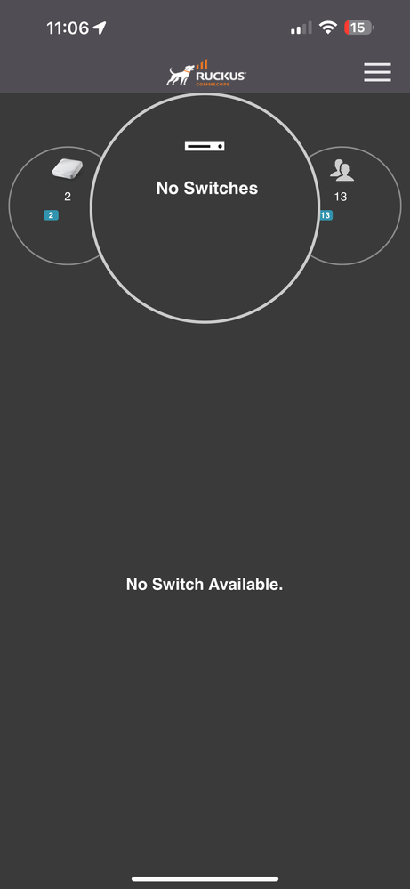

I just purchased a Lennar Home from a previous owner (not directly from Lennar). I had to do a hard reset of the access points so that I can reconfigure them and set up my own admin and WLAN login and passwords. After I updated the firmware for the two Ruckus access points, I set up a WLAN using the Ruckus Unleased app. However, the AT&T Fiber router is still broadcasting its own wireless network. Also, the Ruckus switch is not being recognized at all in the Ruckus Unleased app. I read in other threads that the access points should be set up in bridge mode, but there is no option for "bridge mode" in the Ruckus Unleased app, so I don't know how to set that up. How can I set up this WLAN properly so that there is only one wireless network being broadcast throughout the house and so that the Ruckus switch is recognized in the Ruckus Unleased app? How do I get the AT&T router and the two APs on the same WLAN? There have not been any power outages since I've moved in.

Please note that there will be different WLANs from Internet Service Provider's (ISP) Router and RUCKUS Access Points. RUCKUS AP WLAN cannot be merged with Router's WLAN.

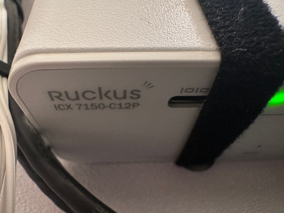

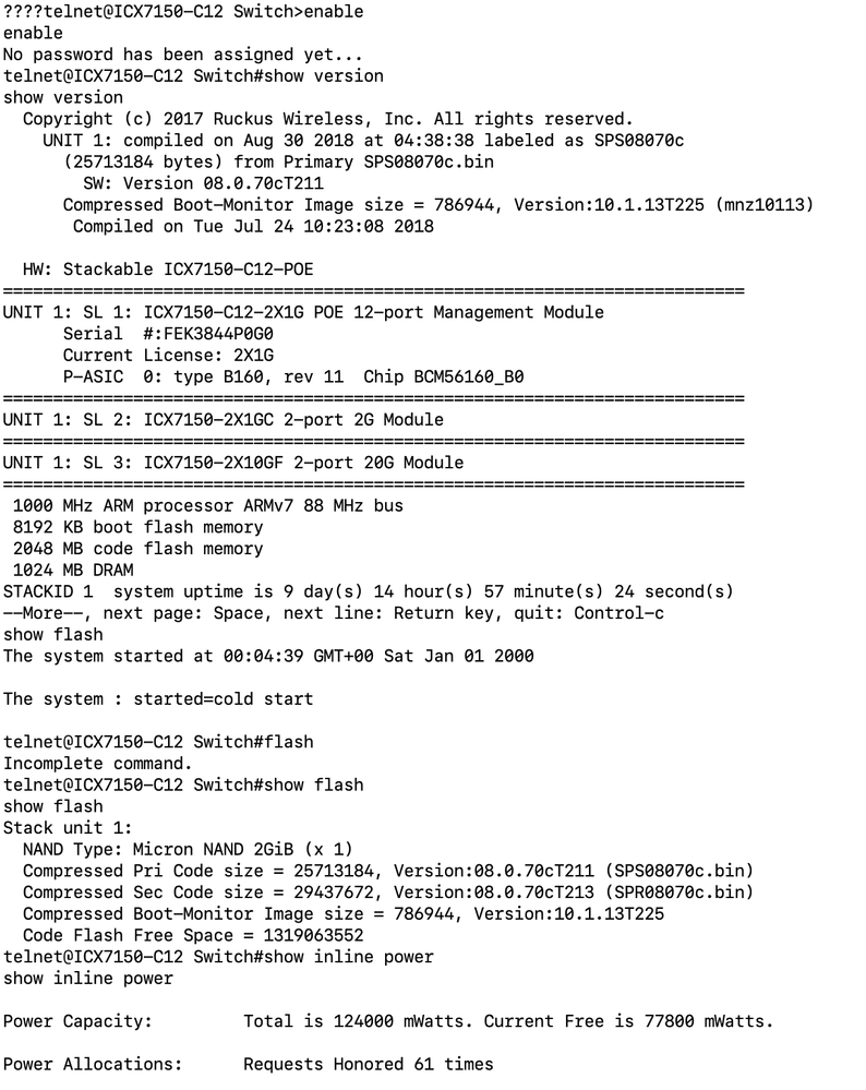

For Switch not getting added into the Unleashed app may be due to an older version of the RUCKUS ICX-7150-C12P Switch. To check the same we may need to check version and some configurations of your RUCKUS ICX-7150-C12P Switch.
To proceed with troubleshooting the issue, please follow the steps outlined below to access the Command Line Interface (CLI) and provide the necessary command outputs:
1. First, identify the current IP address assigned to the switch ICX-7150-C12P by your local router. You can use an IP scanner tool to easily locate the switch's IP address on your network. Here is a guide on how to perform this using IP Scanner free applications:
2. Once you have identified the IP address of the switch, proceed to access the Command Line Interface (CLI) of the RUCKUS ICX-7150-C12P switch. Here is a guide on how to access the CLI:
If you can access the Command line the prompt should look like below:
ICX7150-C12 Router> OR
ICX7150-C12 Switch>
3. After successfully accessing the CLI, please execute the following commands and provide the outputs:
show version
show flash
show inline power
show inline power detail
show interface brief
Please share the command outputs or screenshots if you encounter any issues or errors during these steps.

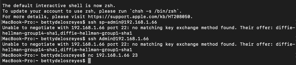

Hi @Clark
Please note that, for newer versions the Telnet option is disabled for security reason and default username/passwords are not working for SSH. That is the reason you are unable to access the it.
You can access CLI using console connection and reset the username/password. Please refer to the below guide on how to get console access.
While you have the laptop connected to the Switch with a console USB cable and the CLI screen up it asking a username/password, reboot (unplug and plug from the power outlet), and follow the video below.
https://www.youtube.com/watch?v=0ynKwSTpd_A
Once you have successfully recovered the switch password, use the following commands to either modify the existing password or create a new username and password:
configure terminal
device(config)# username super password pass
In this example, the username is ‘super’ and the password is ‘pass’.
To ensure proper authentication, execute the following commands:
device(config)# crypto key generate rsa
device(config)# aaa authentication login default local
device(config)# aaa authentication web-server default local

Here is what I get from the commands:

Hi Imran,
Thank you for your help so far. I was able to follow the instructions to update the switch firmware on the secondary partition using Telnet via Terminal on my mac and the USB method. The switch is now recognized in the Unleashed App. However, I am now trying to copy the firmware to the primary partition and now when I go into Terminal, it is no longer allowing me to access the switch via Telnet or SSH as shown in the screenshot. What has changed? How can I access the switch now to make future updates to the firmware if I cannot get in at all anymore.
