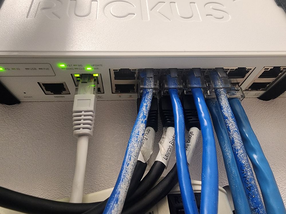

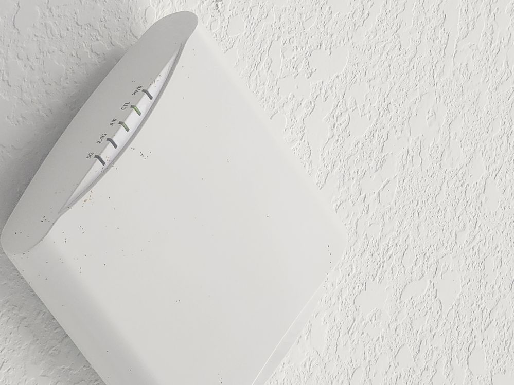

Hello,
For the first picture their are blinking green lights for the options; AIR, CLT, PWR. And for the second photo their are green lights only for the black cables at the back.

Thank you for your prompt response and for providing the information. Based on the current status indicators of the RUCKUS ICX-7150-C12P Switch and R510 Access Points, it appears that they are operating normally.
However, upon reviewing the picture you provided, it seems that the Ethernet cable from the ISP's router or modem/router combo is connected to an incorrect port on the Switch. For optimal performance, this cable should be connected to ONE of the 12 designated ports on the Switch, as illustrated in the screenshot below.
Please disconnect the Ethernet cable from its current port and replug it into one of the designated ports. After doing so, kindly reboot the ISP router by unplugging it from the power source and then reconnecting it. Once the router is back online, try to reconnect to the Internet via the Access Points.
Should you encounter any further issues or have any questions, please do not hesitate to reach out.
08-30-2024 07:37 PM
Hello, Thank you for the information. I fixed that however, it is still showing up as a lock network in the previous home owner name. I am requesting assistance in helping me troubleshoot the login process inorder to change that information.
