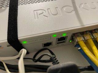

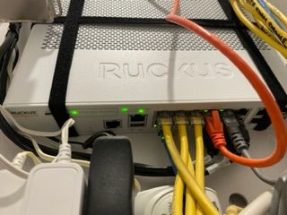

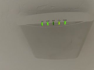

2. May I know how many Access Points are connected to the Switch? Could you please let me know the light status on the Access Points? Any of these lights are on (Please refer to the below picture and share a picture of the same)

Here are the best pictures I can get. The switch panel is in a media enclosure so it’s a tight fit try to get all of the lights and ports in a picture. I only have one switch in the middle of the house

Hi @Chaycen
As per the lights status of the RUCKUS ICX-7150-C12P Switch and Access Points, they are in a normal state. Please follow the below process and help me with the queries.
