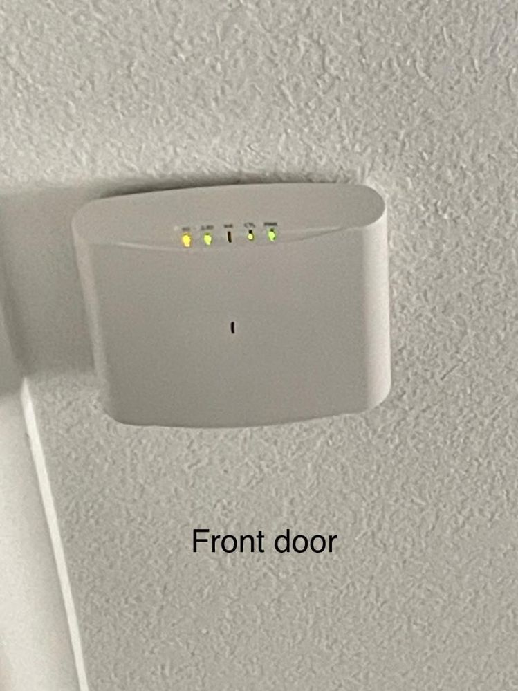

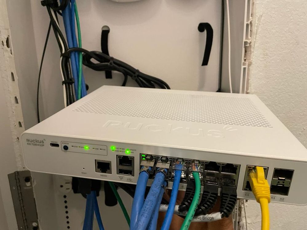

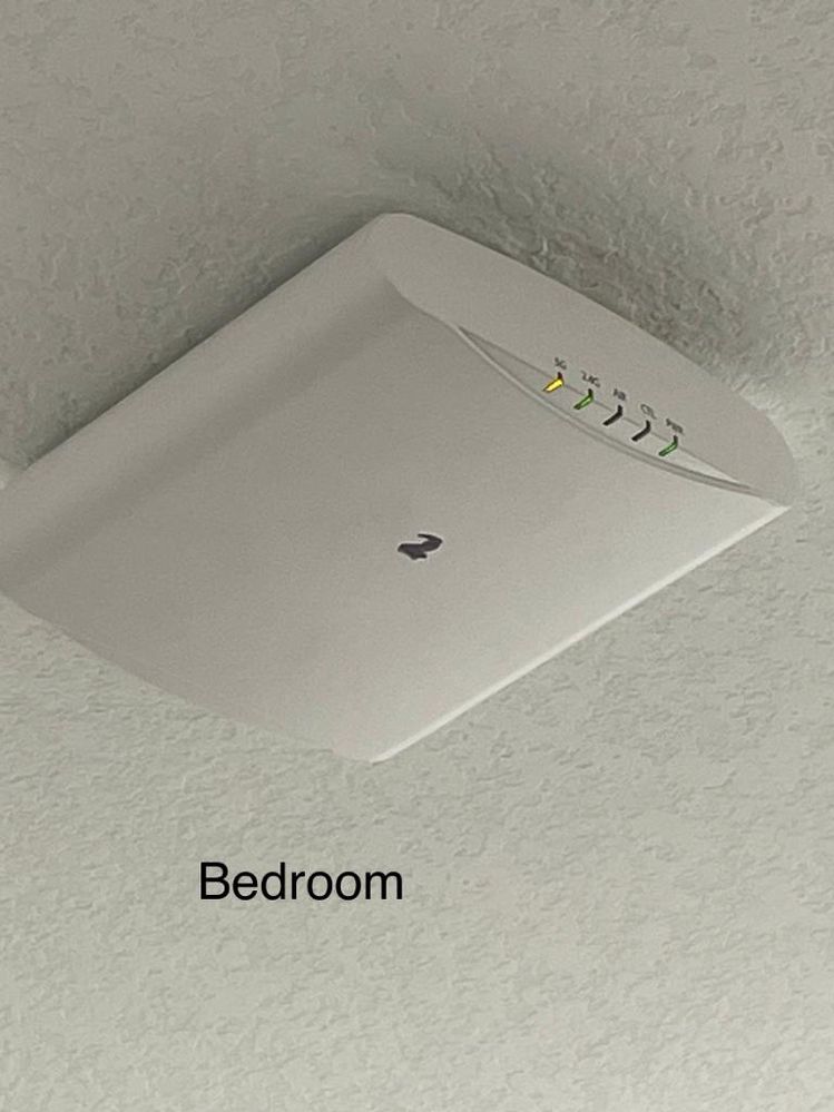

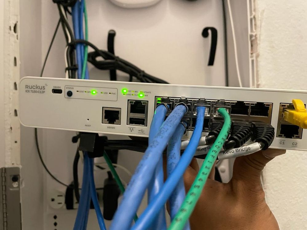

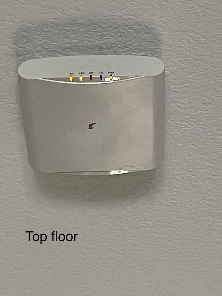

WhatsApp Image 2023-10-31 at 15.02.22_08b40e4a.jpgWhatsApp Image 2023-10-31 at 15.02.22_20a89fa1.jpgWhatsApp Image 2023-10-31 at 15.02.22_900a4829.jpgWhatsApp Image 2023-10-31 at 15.02.22_c7d5988e.jpgWhatsApp Image 2023-10-31 at 15.02.22_d6e47458.jpgDear Community,
I am struggling with poor Wi-Fi network in my home. I recently bought it and it comes with 3 Ruckus APs and one ICX7150. I tried to skim through several blogs but couldn't get any solution.
Please help me configure it.

Hello Imran,
looks I am running in to some issues. Here are the my steps :
  • Removed two cables from the switch ( so only one remained)
  • physically reset the switch.
  • after 2nd attempt, I got the “configure-me—xxx” option.
  • I followed all the steps in the app. It asked for creating a Wifi password and a admin password that I did ( in the Mobile app).
  • Now it  is showing me as one of the options to connect to Wifi in the list of options.
  • then I connected rest of the two cables for APs.
However, I am facing issues:
1. I am not able to access the portal for management. It keeps showing me same messages as attached.
2. the other two APs are still showing amber for both 2G & 5G.
3. somehow all three APs are also showing as connected in my AT&T “smart home manager” app. I am thinking, ideally that should not happen as the APs are connected through switch and not directly.
4. I also lost connection to one of my previously connected device (pool management app).
 Kindly advise.
