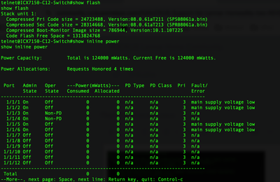

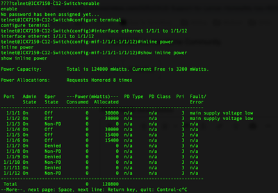

Thank you. I have telnet’ed I to the switch and run the commands as per the instructions. The following is the output. First image is prior to running commands and the second image is after.
However access points are still not receiving power.

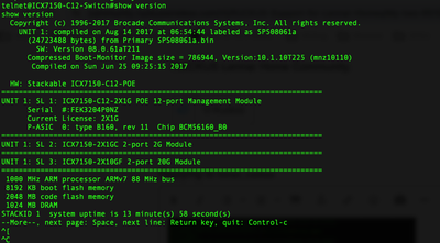

Hi @zacvacek
Please enter the below commands and share the output.
show version
show flash
show inline power
show interface brief
