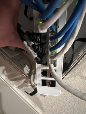

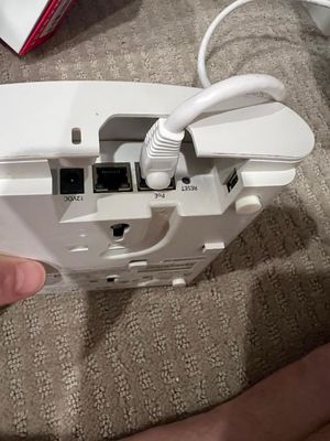

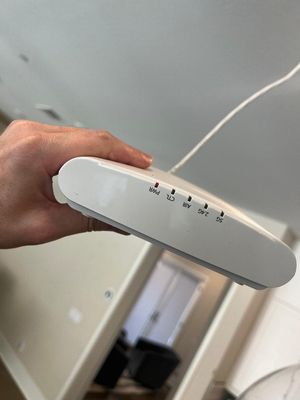

Thanks for the guidance.  Followed the instructions you provided, but unfortunately the AP is still stuck on a  red light on the front and no green lights on the back.  See photos.

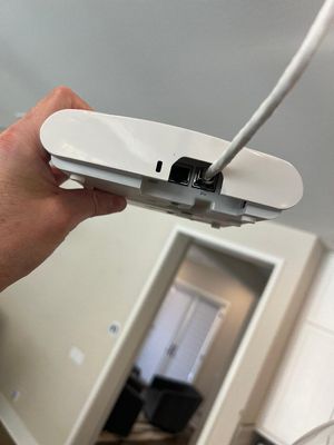

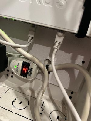

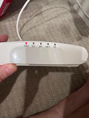

Good evening - Followed your instructions (see pics) and same result.
