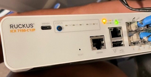

Hi @Ramesh
Thanks for the information provided.
Please share the image of the switch showing LED light status.
Valued Contributor III
Hi @Ramesh
Based on the image you have shared, if the switch has green and yellow light, it means that the switch is stuck in boot mode.
Please follow the below steps to solve the issue.
1- Try to disconnect from the Power outlet the ICX- 7150 and reconnect it.
2- Please try to press the reset button using a paper click or a small stick
  1. Remove power from the switch.
If the resetting process doesn't work, we need to perform a software recovery.
Here is the quick guide to perform software recovery.
Note: after fixing the issue of the Switch been stuck in boot mode, please perform an upgrade to the code 08095g UFI and upgrade both partitions with the switching code file named SPS08095gufi.bin, so perform the software recovery using the code 08090k with the upgrade image file named SPS08090k.bin, then when the switch is back to normal upgrade to the file SPS08095gufi.bin for both partitions primary and secondary.
