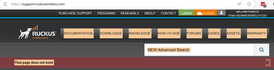

11-19-2024 06:22 AM
Thanks Imran. The link you provided takes me here and tells me the page does not exist.
11-19-2024 06:46 AM
Hi @wrfowler
Thank you for your response and for your patience.
Apologies for the inconvenience you've experienced. Upon checking with the internal team, we've identified that there is a technical glitch on the portal, which is preventing you from accessing the upgrade software tool. Our team is actively working on resolving the issue, but please note that it may take some time.
In the meantime, you can download the software tool directly from the following drive link and proceed as instructed in the user manual:
If you have any further questions or need assistance, please don’t hesitate to reach out.
Thank you again for your understanding.
