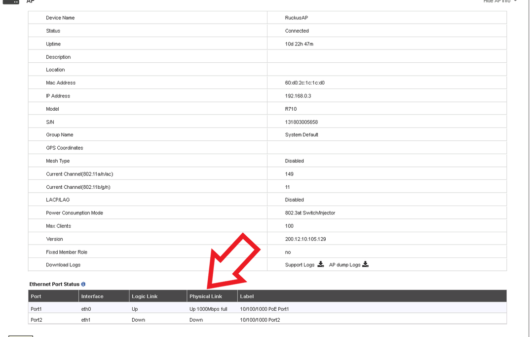

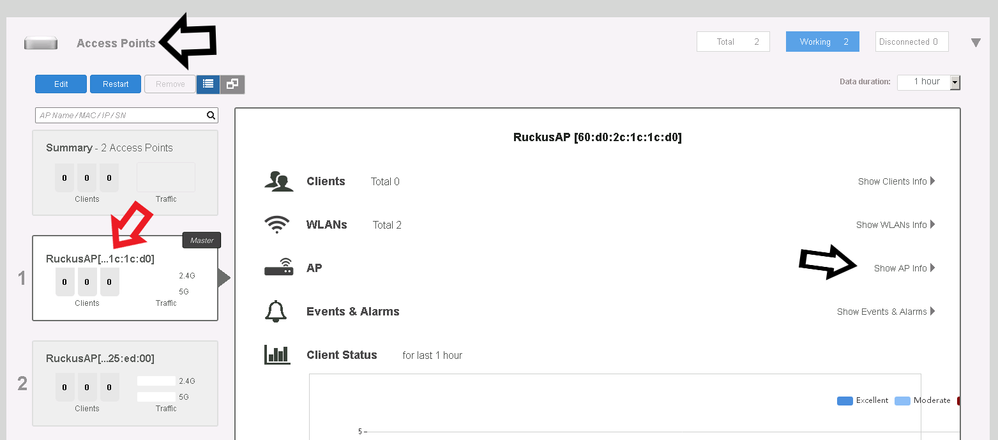

2-Made sure that Wired ( Ethernet that goes from ICX-7150 C12p to the Access Points ) Many times these cables are found to be damaged and generate heartbeat loss.
Here is a guide how to check if the APs are 1G or '1000'
